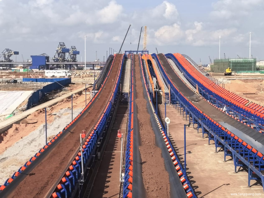

几内亚铁矿的皮带机运输是全矿的流程中枢,一旦皮带机无法正常工作,将导致全矿停产,造成巨大经济损失。因此,高压调速系统必须具备极高的可靠性、稳定性和防护性。
基于上述工作特点,变频器设计需满足以下主要技术条件:
The conveyor system is the central link of the entire Guinea iron mine. Any failure in the belt conveyor would lead to full-site shutdown and cause major economic losses. Therefore, the high-voltage speed-regulation system must provide exceptional reliability, stability and protection. Based on these operational characteristics, the VFD must meet the following requirements:

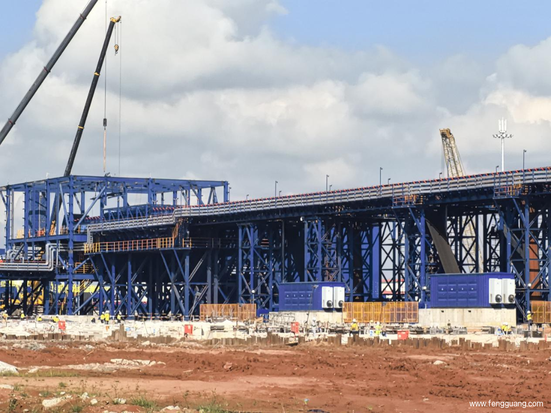

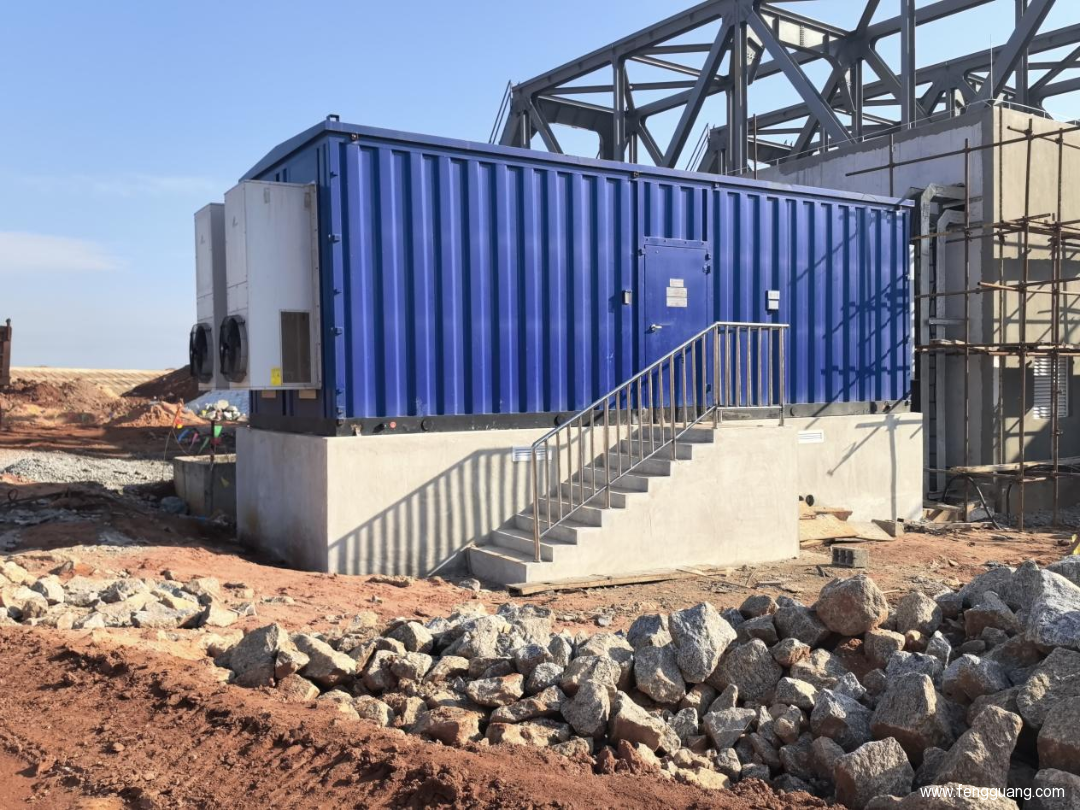

经过对各类高压变频器厂家的调研和比较,几内亚项目最终选择了新风光JD-BP38系列高压变频器作为皮带机的控制设备,现场共配置多台集装箱式高压变频器进行控制。
After evaluating various suppliers, the project selected FGI’s JD-BP38 Series High-Voltage VFDs as the control solution, with multiple containerized HV VFD units deployed on site.

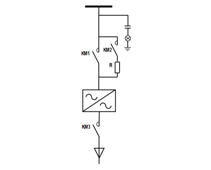

皮带机变频主回路接线图
Main Circuit Wiring of the Conveyor VFD System
现场采用3套新JD-BP38系列高压变频调速系统,根据用户要求,变频器控制系统采用主从控制,“一拖一”控制方式。3台高压变频器主回路接线方式相同,以其中一台装置为例,一次接线如图
Three JD-BP38 HV VFD systems are deployed on site, using master-slave mode and “one-to-one” motor control. All three units share the same wiring configuration, shown in Figure 1.
一拖一接线柜(带缓冲)一次回路图
One-to-One Wiring Cabinet (with Buffer)
Primary Circuit Diagram

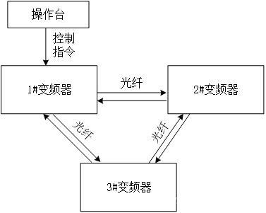

主从控制
Master-Slave Control
如皮带系统简图所示,选用1#变频器为主变频器,2#和3#变频器为从变频器。操作台向主变频器发送给定频率值,主从变频器之间采用光纤通信,1#变频器作为主控,检测所有变频器的运行电流,计算并发出输出转矩给定值,控制从变频调速系统同步运行。
As shown in the simplified conveyor system diagram, VFD No.1 is selected as the master drive, while VFD No.2 and No.3 operate as slave drives. The control console sends the frequency command to the master VFD, and optical fiber communication is used between the master and slave VFDs. Acting as the master controller, VFD No.1 monitors the operating current of all VFDs, calculates the required torque output reference, and issues torque commands to ensure synchronized operation of the slave VFD systems.
高压变频调速系统简图(BC4A)
Simplified Diagram of the High-Voltage VFD Speed
Regulation System (BC4A)

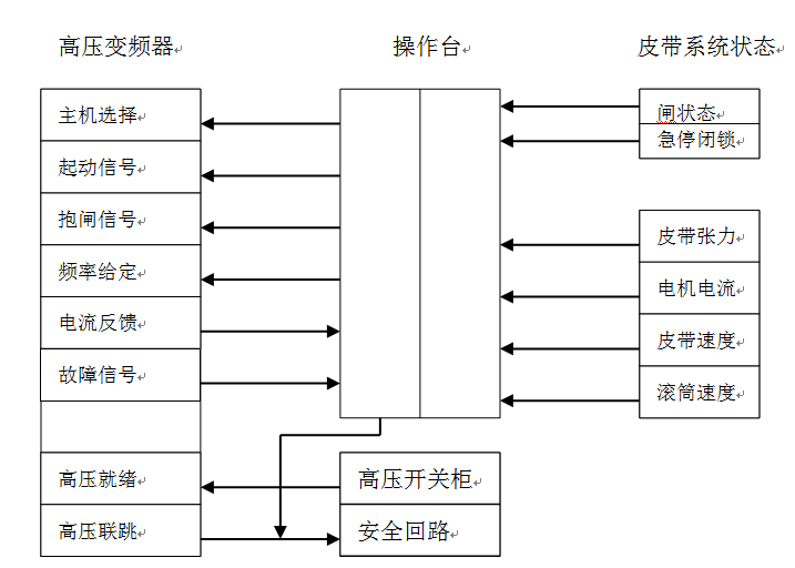

皮带电控系统控制原理图
The control principle of the conveyor electrical control system
皮带电控系统控制原理
Control Principle of
the Conveyor Electrical Control System
起车时,皮带电控系统首先对皮带系统传送的信号进行判断,如跑偏、堆铁、纵撕、急停闭锁等,若各信号正常,方可进入下一程序。
When starting, the conveyor electrical control system first checks all signals from the belt system—such as belt deviation, material buildup, longitudinal tear, and emergency stop interlock. Only if all signals are normal will the system proceed to the next step.
当皮带机各部分均处于正常状态,具备起车条件,才会发出启动信号。发出起车指令后,变频器启动。
When all parts of the belt conveyor are confirmed to be in normal condition and meet the start-up requirements, a start signal is issued. After the start command is sent, the VFD begins operation.
同时,操作台发出指令使抱闸打开,并检测抱闸是否完全打开。若抱闸未打开或未完全打开,将关闭运行信号,并给变频器发送抱闸信号使其急停,防止因堵转而过流跳闸。
At the same time, the control console sends a command to release the brake and monitors whether it is fully opened. If the brake does not open or fails to fully open, the system will disable the run command and send a brake signal to the VFD to perform an emergency stop, preventing overcurrent trips caused by motor stalling.
当皮带达到额定速度,电控系统实时检测皮带速度与滚筒速度,若二者速度差值超过规定值,紧急停车,并发出打滑报警信号。
When the belt reaches its rated speed, the control system continuously monitors the belt speed and drum speed. If the speed difference exceeds the specified limit, the system will execute an emergency stop and trigger a belt-slip alarm.
系统实时监测电机温度、减速器温度、轴承温度、皮带张力、电机电流、抱闸状态、变频状态等参数。一旦任一指标或状态出现异常,系统将立即紧急停车并发出报警信号。
The system continuously monitors parameters such as motor temperature, gearbox temperature, bearing temperature, belt tension, motor current, brake status, and VFD status. If any parameter or condition becomes abnormal, the system will immediately initiate an emergency shutdown and issue an alarm.
